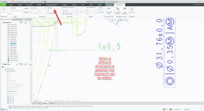

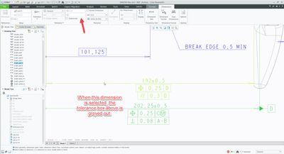

See pictures above. I am having trouble editing the tolerance on a drawing. Only the one that I want to change isn't working of course. I think it might have something to do with it being a draft dimension. Thanks in advance!
I switched General to None and that allowed me to change it. Thanks!

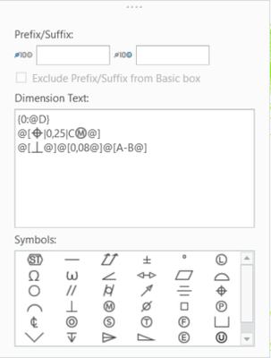

Check the dimension text box and see if the tolerance was manually added.

Try to switch from General to Symmetrical.
