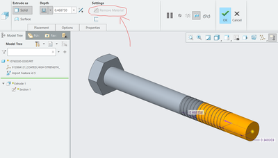

I want to extrude away some threads on hardware models that I imported as STEP files.
When I go to do this the "remove material" option is grayed out.
Questions:
  1. Why can't I extrude cut imported geometry?
  2. Is there an error in the model that needs to be repaired before I can do this?
  3. Is there another way?
Bob
5 REPLIES 5
Your imported geometry is surfaces only, no solids.  With no solids in the model, Creo has nothing to cut.  If you switch the feature to a surface, you will be able to cut the surfaces.
Solidify the imported surfaces and you will then be able to cut away the threads.  This may be as simple as redefining the import to be a solid, or may require repairing the import.

Is STEP file imported as solid or surface? Surface model is one of the common reason for such issue.
If it is a surface model, try solidify that prior extrude.

As others have said, most likely your imported model is surface geometry. Generally Creo imports as solids if he can, which means your import probably has some errors. This leaves you with two options:
  • If you need the part as a solid, you'll have to repair it using the Import Data Doctor, or remake it yourself (it doesn't look too complicated).
  • If you're ok with a surface model, make your extrude as a surface and then merge the quilts together. With some luck, you might even cut away the bad geometry and be able to solidify the part afterwards.
