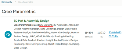

I think that you have chosen the wrong forum.
You'd better try there::
