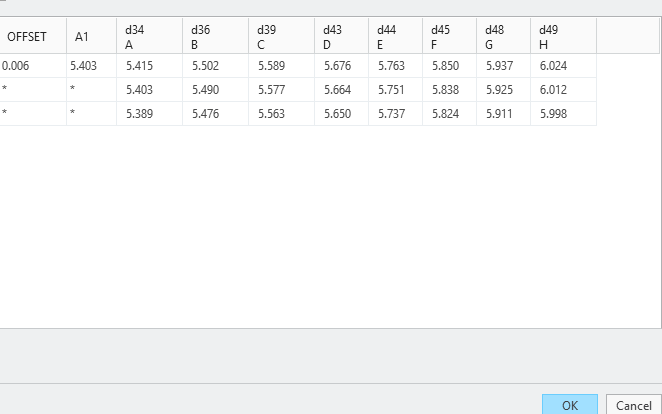

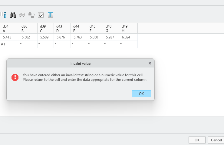

Hello
i am struggling to add the new dim Parameter in another instance in the family table. Apparently, it doesnt like parameter names.  i thought i could rename the original dim (A, B,..so on), add an offset, create new dim as a parameter,
error "you have entered an invalid text string or a numeric value"
apparently, it needs to be a number. what will be another workaround?  Ultimately, i want use these new parameter (A1, B1, C1, D_1, E1, F1. G1, H1) in a drawing table.
It seems that i have to convert the string into a number?

SikiF
(To:joe_c)
What you are trying to achieve is not possible due to invalid value types.
Explanation:
For dimension d34 (A), the value type is real (this applies to the entire column), and for A1 it is a string type (A1 in this case is not treated as a parameter used in the relation, but as an actual value).
These two types are not compatible with each other.
As the dialog says, you must use a value of the same type!

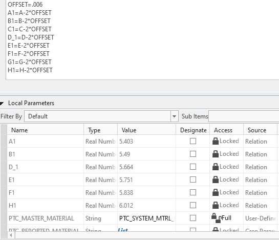

joe_c
(To:MartinHanak)
thanks Martin
But i already did that but A1 is assigned to the 1st instance instead of the second.  I want to keep the 1st instance at a zero offset (which is the original A, B,,, dimensions). The second instance at the 0.006 offset with the new A1, B1 the third instance at a 0.013 offset and so on..... Right now, i am typing the calculated new dimension in the table instead of the using the relation based dimension
i also want to add the new parameters in a drawing table so the threads can be machined at the different offsets from the shoulder (left or right)

KenFarley
(To:joe_c)
Seems from what I see that you could define all the dimensions from B to H as distances from A. These seem to be unchanged for all versions of the part. Then your family table would only need to specify the offset. For your first "nominal" version, just enter an offset of zero.
A version table or list of the versions on the drawing would then consist of a list of the offsets for each version.

joe_c
(To:MartinHanak)
Martin
here is creo picture of what i am trying to do accomplish.. by moving the threads/knurls to the right using the equation in the relations and add it in the family table instead of typing the numbers

KenFarley
(To:joe_c)
I've done things like what I presume you are attempting. An approach I think would work well is as follows:
(1) Define a set of parameters that will contain the "nominal" values of a particular instance.
     Anom, Bnom, Cnom,...,Hnom, etc.
(2) Define a parameter for your offset
(3) Define a set of relations that use the nominal values and the offset to set the pertinent dimensions
     A = Anom - 2 * offset
     B = Bnom - 2 * offset
(4) In your family table, for each instance, specify the nominal values and the offset.
