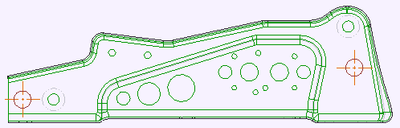

I just started using CREO (started at 7 we just upgraded to 10) and there is something that's been bugging me about how CREO manages Ordinate Dims.
So, I've used NX and SolidWorks in the past. In both those programs I could start an ordinate chain by selection 0-0 and place Dim chains. In both those programs - if later on you need to change the 0-0 (origin) you would edit one or both 0-0 Dims - select a new reference and all of the dims updated. When I first started using CREO 7 I thought this would be a thing. Apparently, it was not. My colleagues even warned me if your 0-0 loses its reference (due to surfaces/design changing) you had to trick the origin into finding itself again. I performed a search - and I believe this has been going on within CREO since maybe 3.0. That seems crazy.
So, leapfrogging to CREO 10 I was like - this definitely got fixed right? Well, I sense that this still isn't an option. How can this be? This is CAD 101 - allow for modification/changes to increase productivity and address any errors you find while using tools that have been provided you.
Does anyone know how to reassign 0-0 after initial placement? How to fix a dangling 0-0 if surfaces change? And please don't forward me to the - "Change the first know ordinate dim to linear - then force back to ordinate and hope it works" That is kludgey.

I'm thinking you are going to be disappointed in the answer. You can used edit attachment and that does sometimes work. Sometimes it doesn't.
I've never tried to specifically change the origin.  My quick check doesn't give me any confidence it's possible.
Creo drawings will cause you to go insane at times.
If the ordinate dimension was originally created as a linear dimension and you can figure out which dimension was the first, on occasion you can switch it back to linear, fix the reference, then switch it back...I think it worked for me once, usually it doesn't. I gave up years ago. If I have a failed origin, it's just faster to re-create the dimensions than it is to try to hack a solution.

Try this: in your model put a datum plane where you want to start your baseline (0,0). Make that datum plane independent from model geometry (use base datum offset) if you change geometry and want baseline to stay where it’s at. If you want baseline to move with modified geometry, then adhere datum plane to the geometry surface by (datum, through, select surface) then the baseline (0,0) will stay with geometry.
I tested this and it worked. I give credit to my coworker, like me, a Mechanical Designer, who provided this simplistic approach. We are in parametric land so ‘methodology” is key.
