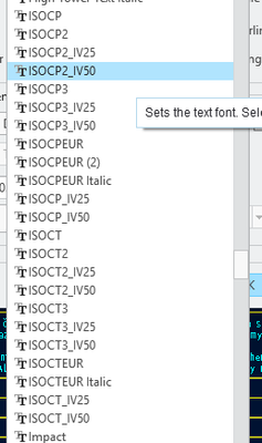

Several people I know worked on this and the resume was to give up. Vector fonts are not working properly in creo and you want to elimitate the thing that your drawing looks different on paper than on your monitor. In case I want some CNC laser text done I use them with these export settings or I just do 0,01mm extrude a text on a part. We switched to true type. The advise from official creo distributor in our country was to install ISOCP fonts, we are using ISOCPEUR as default now. It looks technical and similar size like ndx font and we export ttf to ttf.

I see and understand, very clever idea but sadly I dont think there is way to do it. Creo doesnt have this solved very well and building software with base font from 1995 will bite you in the ass somewhere. Hopefully somebody knows more...that would save my time too!
Only experimental way I know would be probably manually porting isofont.src file into .ttf which you can install on windows, that should work after export 1:1. Porting will take probably week but still better than rework all the drawings several times a year.
