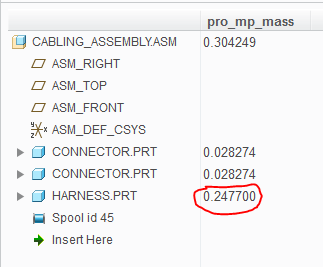

Hi, everyone. I'm having an issue with getting a proper mass of my harness parts. Rather, the mass is right but the unit is wrong. I used the Creo mmns template file for my harnesses and now they report mass in tonnes. I want to change the mass units reported with the PRO_MP_MASS parameter, but since I cannot open a harness part by itself, I find no way of getting into the model properties to be able to change it. Does anyone have a workaround for this?

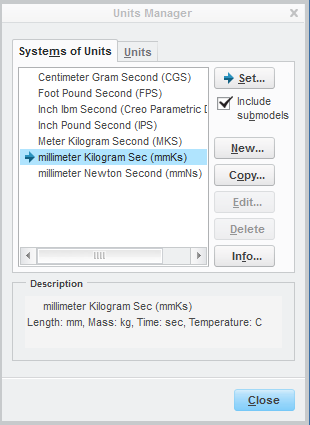

I hope I found a solution ... see attached CS155622.pdf.
1.] activate Cabling assembly
2.] click File > Prepare > Model Properties, then change in Units row
3.] set a System of Units and tick the "Include Submodels" box to propagate to harness
4.] regenerate assembly

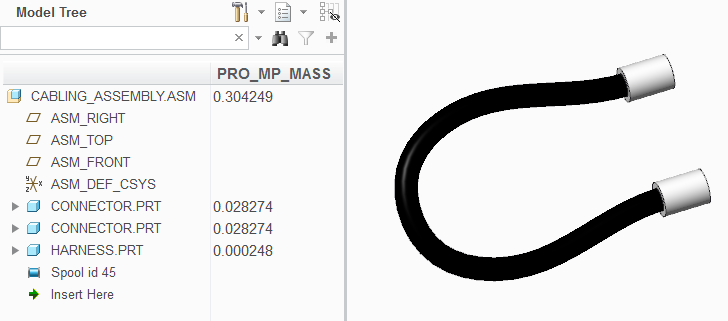

Sorry, didn't mean to seem ungrateful. I've uploaded a zipped cabling assembly. The assembly and connectors are all in mmks, whereas the harness is in mmNs. Basically, the assembly was created as mmNs, but then changed to mmks. Now I want to change the harness part, as well. The reason for this is that the PRO_MP_MASS parameter of the harness part reports in tonnes, rather than kg. If you look at the screenshot below, you can see that the mass parameter of the harness part is significantly lower than the connector parts. I'm using Creo 3. Very thankful for any assistance!
(This is not my original assembly, which I cannot share since it belongs to a customer, but it's the same issue, except for that assembly having several harness parts, and redoing it from scratch isn't an option.)
Martin Hanák
I can't believe I missed this obvious solution. I never noticed that checkbox before. Thank you so much for your help.
