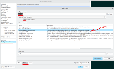

pausob
(To:HBreton)
FYI, the find tool in the configuration editor sometimes works well to get you the answer:
