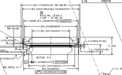

When I convert a metric part to inch I get 12 decimal places on the drawing. how to I limit the decimal places to 4?

Once you have the drawing converted to metric, select all of the dimensions. One of the tabs will be Precision and it will have a drop down for you to select the number of decimal places to show on a drawing.
On metric drawings, decimal places are not used to specify the default tolerance for a dimension like an inch drawing.
You should also look at setting the lead_trail_zeros detail option.
Whats the best way to select all dimensions? I tried doing a zoom cursur to highlight everything but the precision tab wont show. If I select them individually holding the ctrl key it works.

I do not know of any way other than selecting them all with the Ctrl key and mouse clicking.
You can type
       CHANGE_DIM_FORMAT '0.1111' ALL
on the command line as well.
