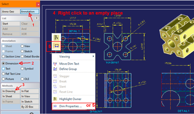

In the bottom right corner you can choose just to select Dimension:
Select everything in the drawing, and then at the top you will have the Round Dimension option:

You can type
       CHANGE_DIM_FORMAT '0.1111' ALL
on the command line as well.
http://kotom.eng.free.fr
Push F2 for selection then (look better attached file 😳)
and change what you want.
Success
Edit:   Ps. How do you do that?   >'When I convert a metric part to inch'

(I'm using Creo 7, I hope these are the same in Creo 5)
