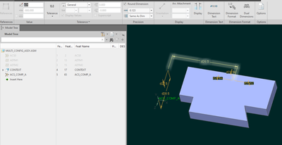

I am in need of controlling the coordinate system position of a part (in the assembly-relation window) with conditional format for the pro program,
Case:
I have a assembly in that assembly one standard sub-assembly group will be there at middle  portion and another component (Part-A) will be assembled in the left side so this will be my one of the requirement and that same part (Part-A) has to be assembled in the right side for my another requirement,
for this i am assembling only one time Part-A in the model tree by using coordinate system (Part cys + Ass cys) so for the other case i need to change the coordinate system position so that Part-A will be moved to the opposite side,
Please refer the attached snap.

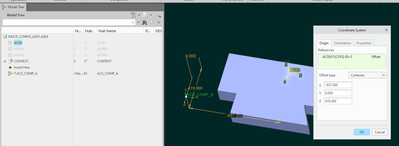

One option is to use a transform matrix to define the csys (used to place the subassembly) location relative to the assembly default csys. When done this way you can use relations to change the values of the transform matrix thereby moving the part from one location to another without creating a new csys. You only need to change the values of the transform to move the csys to a new location and orientation.

1) the location of the coordinate system in your main assembly that is used to constrain part A can be changed because it is defined as offset from default.  Hence, the 3 translations and 3 rotations are readily accessible dimensions that can be modified by relations.

so you define the offset coordinate system in your main assembly:
Note the dimensions you want to control:

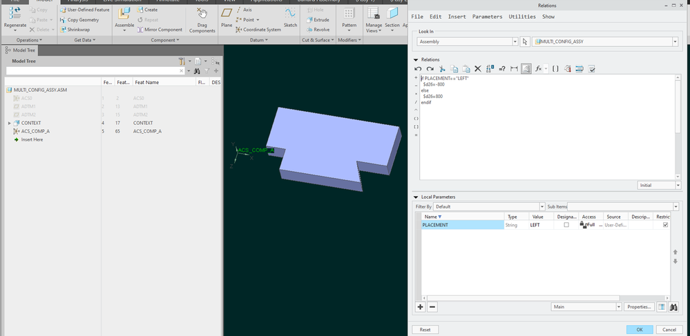

Here is an example of the relation that determines the value of the d26 dimension:
So if the value of the parameter "PLACEMENT" is "RIGHT", then the coordinate system will be on the right side:

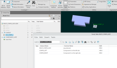

However: note that there is no need for relations or the "PLACEMENT" parameter if you simply use family table to manage the 2 configurations:
The relations and parameters add a layer of complexity that future users of these models might not understand.
Additionally, when using these assemblies as sub-components in another top-level assembly, the family table instances are easily identified in the model tree:
And the family table route is definitely more appropriate if this assembly is actually identified by a different part number depending on which side its sub-component A is installed.

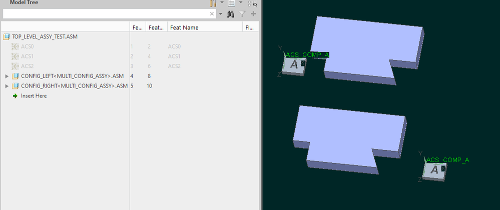

Hello Thanks for your reply on my post,
i have attached a image, here i have a assembly and under this assembly one part has been assembled by co ordinate system in the left side, same part has to go to opposite side when i am changing the paramater as Right (see on top),
is that possible by changing the co oridnate position of the PRT0002? if so please shom me the syntax.
