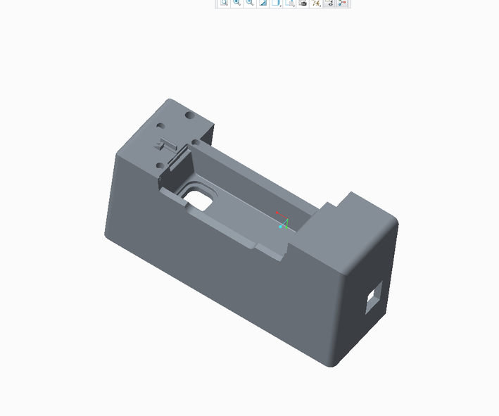

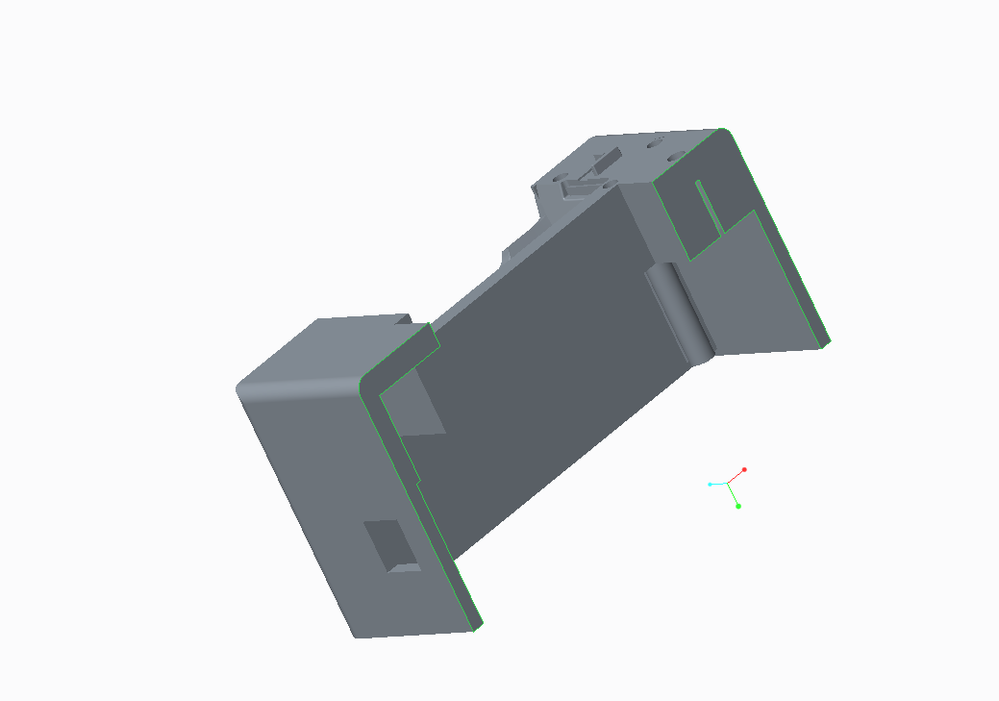

I am having some trouble copying and pasting an entire part. I want to take this part in picture 1 and copy and paste and identical part on the back side (highlighted in green in picture 2) of this part.

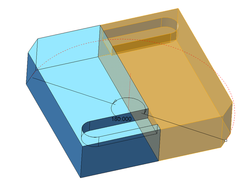

This is how I would do it, by Copy/Paste special with 180-deg rotation.
...or you could create a Circular Pattern 🙂
