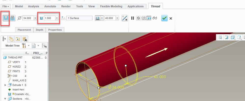

Can anyone guide me how to create Cosmetic thread with different pitch.
Eg. M36x4 is the standard cosmetic thread instead I want to create for M36x1.5
1 REPLY 1
StephenW
(To:atools)
The cosmetic thread feature using the SIMPLE THREAD asks what pitch you want, so you just key it in.
You can't use the standard thread because it's not standard.
