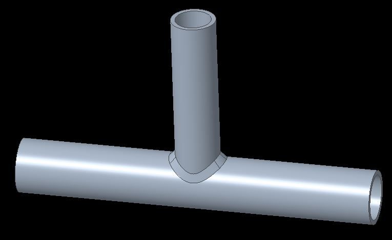

I am trying to create a solid weld fillet between two round pipes, to be calculated in Creo Simulate, but I can't figure out how to.

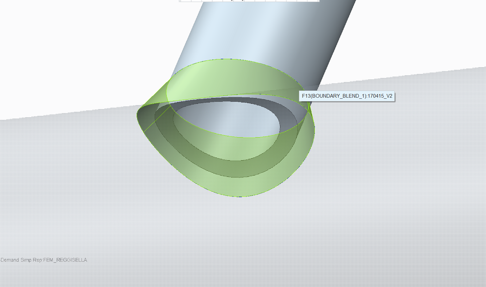

I managed to create the outer surface with a boudary blend (green in the picture):
after that, what I need is to solidify the inner space between: green surface-vertical pipe (grey)-horizontal pipe (transparent).
Anyone has ideas/indications on this?

I found a way to it, for those who may be interested.
It's made by creating surfaces for the other borders of the solid fillet space, then merge all the boundary surfaces and finally solidify gets done.
I enclose a video showing the steps.
