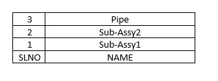

In continuation, is it possible to show a specific component of a sub-assembly in the BOM table of the main assembly by using Relations/ rules in Filter.
For Example:
In the below Assembly structure, Main Assembly is made of Sub-Assy1 and Sub-Assy2
If any of these Sub-Assemblies contain a pipe, I need that to be shown in the BOM table of MAIN Assembly
Is it possible to do this with help of relations/Rules in the repeat region?
 Assembly_treeAssembly_tree
MAIN ASSEMBLY BOM TABLE:
Bom_TableBom_Table
Thank you!

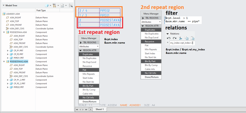

you can define 2 repeat regions, first one for top level components and second one for pipes.

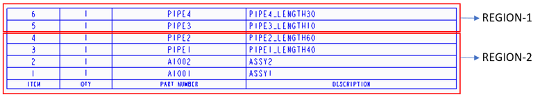

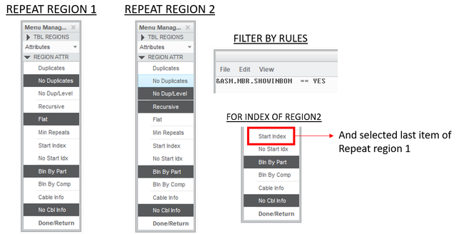

Assembly structure of Main assy is as follows:
The Pipe.prt is modeled with flexibility and I introduced a parameter called "ShowinBom" and set it as a boolean value. I leave this parameter set to the default value "NO" and I set this value to "Yes" only when its a part of a sub-assy.
in the Drawing, I use two repeat regions
Result is:
Deepak
Hi Deepak,
Just wanted to let you know that you're a lifesaver. You're method worked like a charm.
For anyone reading this in the future who is not sure how to use flexible modelling like me, you can access the "parameters" window through Model -> Model Intent -> Parameters. You can't set an original value, but you can make a new parameter called SHOWINBOM and set it to yes. The rest of the steps are perfect.
