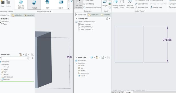

I was wondering how you can add Template views to an drawing template file, and have it show all the model annotations from the model.
The model annotations that I manually added, are not shown automatically now. Is there a setting for this?
See picture:

@BWS Thanks for the image, dimension in image is 3d annotation and setting the config in last reply should help you. But only condition for that is annotation in 3d annotation should parallel to view.

Yes, I have added multiple template views.
But when I make a drawing of an existing model with annotations, these annotations are not shown on the drawing template. I only get the model itself without any dimensions/annotations.

When inserting template view, check "dimensions" to show on crating view.
Also, check config auto_show_3d_detail_items as yes to show 3d annotation in drawing.

I've seen the option to show dimensions. But when I check that box, ALL dimensions are shown.
I only want the annotations on the drawing that are added by myself, and not the model parameter dimensions.
See picture, I would like to have exactly this view with the dimension shown on the picture.
Thanks alot. It is working now!
The problem was that the dimensions were not parralel to the view on the template.
Is it possible to make an isometric annotation plane, create dimensions on multiple sides of the "cube", and use this view on a drawing template with all the dimensions shown as in the picture?
Thanks!

Dimensions in isometric view can display by setting drawing option allow_3d_dimension to yes. Once it is set as yes use Show model annotations to display dimensions in isomeric view.
