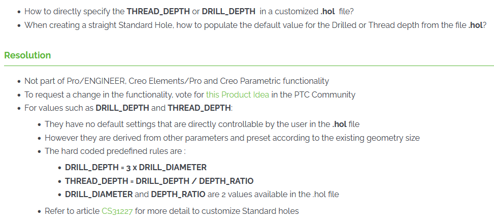

Oh man, I feel like that should be something implemented into Creo in the future. I can see so many benefits to having that option. Sorry for the many questions but I do have one more. I have THREAD_DEPTH and it's values specified but when I use the hole feature, it doesn't automatically populate the correct thread depth value. Is this one that doesn't normally work? I would attach the .hol file but it doesn't seem to allow .hol files.
TomU
(To:JA_9173935)
THREAD_DEPTH and THREAD_LENGTH are parameters that return the current values, they cannot be used to control the depth.  The only control you have over thread depth is with DEPTH_RATIO (specified at the top of the hol file) and DRILL_DEPTH.
From CS99906:

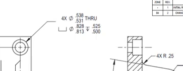

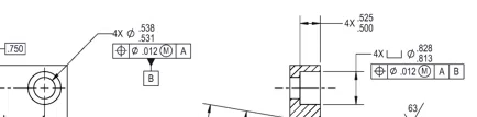

You might find this video interesting:
Look at how the hole callouts look before and after transitioning to GD&T.
Before:
After:
