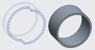

Offset x-section enables you to get following view. Unfortunately section view cannot be displayed in shading mode.
