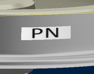

I have just found a way to do this.
Creo 9 has a feature that allows you to divide surfaces.
see youtube video
Creo Parametric 9.0 - Divide and Unify Surfaces
https://www.youtube.com/watch?v=89YwzwPZxQg
this has allowed me to use the decal option
decal on a tapered surfacedecal on a tapered surface
Thank you

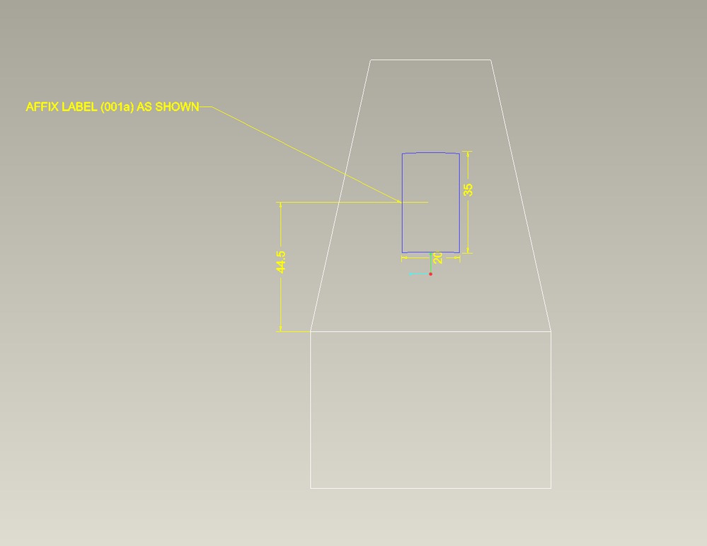

I would not apply high fidelity representations of artwork in Creo. The method I defer to with these situations is to document the location of any artwork (label) in the model/drawing with a shape of the outline and use a note to make reference to the artwork, label etc. Assume the label is a rectangle then just apply the outline to the model which would appear as a box wrapped on to the taper.
For paint call outs I would create surface regions and color code them to indicate where the paint is applied. This can be shown with shaded drawing views as well as displayed in the 3D models.
An example label callout:
