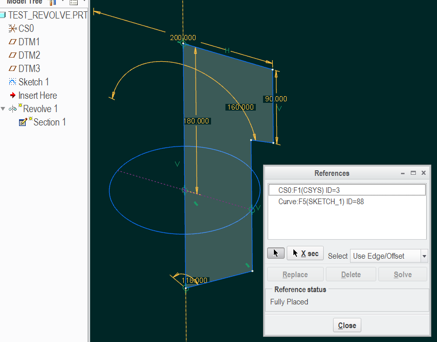

I don't think what you are seeking is possible in Creo.  The dimension you are trying to show belongs to the planar sketch (for sake of argument, this sketch lies on the "FRONT" plane).  Creo isn't smart enough to show it as a radius dimension in the TOP view which is orthogonal to this sketch.
If your company insists on model dimensions only, then you can do something like this:
1) create Sketch 1 (on TOP plane) that contains the radius dimension.
2) use the Sketch 1 circle as a reference in the revolve's Section 1 (which lies on FRONT plane):
Another method would be to just create a reference dimension in the model using the annotation tools.
Either way, you get your radius dimension that can be "shown" in the drawing.
But isn't it so much easier just to make the extra radius dimension in the drawing?
I don't understand the policy of prohibiting drawing dimensions.
