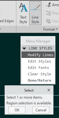

What I do is this: Once I've selected the PhantomTrnsp style, I select all of the lines in the view individually and change the style of those lines using the Line Style tool.

I am not sure if this is obvious, but I suggest this work-around:
1) in your model, hide the components that are not in the "phantomtrnsp" style.
2) in the drawing view, those components will disappear.  So only the ones you want to modify will be shown.
3) then use line style changing tool
and in one go, box-select all the lines of the shown components, and change the line style to your liking.
5) go back to the model and unhide all the components to restore the drawing view.
