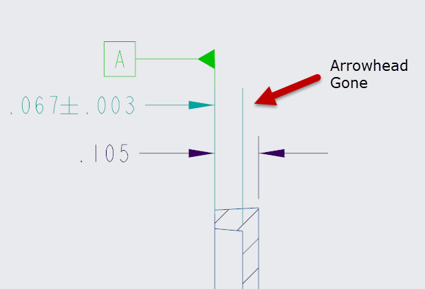

When I attach a Datum Feature Symbol to a drawing dimension (Creo 4, M030) and them move the symbol, one arrowhead of the dimesion I place the symbol on will disapear. After it's gone, there is no way that I can find to bring it back.
Anyone else see this and have you come up with a workaround?

I added an image that should help. It's pretty simple, attach a Datum Feature Symbol to a dimension witness line and then move the symbol. You'll see that one of your arrow heads disapears... Really just wondering how people are getting around this as I cannot believe it isn't affecting other users.

I can reproduce the problem when dimension arrows are flipped ouside. Please report the problem to PTC Support.

Hopefully the problem is resolved in Creo Parametric 4.0 M050.
See:
https://www.ptc.com/en/support/article?n=CS272158
https://www.ptc.com/en/support/article?n=CS278522
Martin Hanák
By moving the Datum Feature Symbol you are converting the symbol from applying to the thickness of the feature to the surface of the part; it breaks a Feature of Size reference.
The defect isn't that the dimension arrow is gone, it's that Creo is letting you move the Datum Feature Symbol at all. Creo should move the dimension and Datum Feature Symbol together or force you to delete the Datum Feature Symbol Annotation. It should not let you relocate the Annotation by itself.
I expect if you do delete the Annotation that the other dimension arrowhead will return.

In the view this DFS is being placed (and in most other views), the "surface" it is applied to cannot be selected (and you cannot select an edge) so the dimension witness line is the only option.
Prior to Creo 4, we would show the set Datum, then move it into the position we needed. It seems in Creo 4 I cannot move my DFS. Hopefully PTC has a solution soon.
I create/apply all annotations in the model and showed them on the drawing. The drafting part of Creo has always had trouble with FCFs and Datum Feature Symbols.
