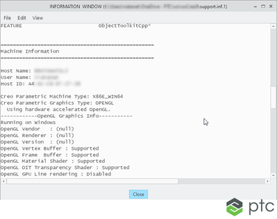

Your appearance gallery display darker colors than expected and the article 328931 suggests that this is caused by the option graphics set to win32_gdi.
One way to check that is to display your display information like so:
Can you paste your and confirm that the line Creo Parametric Graphics Type shows indeed : OPENGL
By elimination this will confirm the article does not apply to your situation.

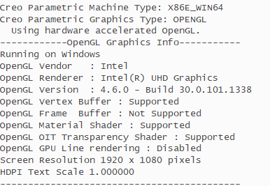

Graphics Type is indeed OpenGL.
The only thing not supported is OpenGL Frame Buffer. I don't think that this should be causing the issue:
About the Frame Buffer, try the option  enable_opengl_fbo yes.
FYI ... in my notebook there is Intel UHD Graphics 620 and I can see the same "problem" when using OPENGL in Creo. The root of this problem is incompatibility between graphic card and Creo.

I had previously installed a few older drivers, but hadn't tried to go back that far. Installing 2+ year old Intel graphic card driver solved this problem. Here's hoping that this won't affect other applications.
Thank you for the help.
