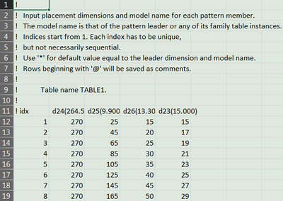

Yes, the sketched point pattern only works well for small number of instances.  Another limitation is that it's a 2D sketch...
If you need to manage 60 of something, then I think that you should look into using table-driven patterns.
Table-pattern your coordinate system:
Then assemble your connector to the 1st instance.  Then pattern-by-reference the rest of the connectors:
That way you can manage and display the design intent information in tabular form...  Also, these tables are manipulated via MS-Excel, which makes generating 100's of instances fairly simple:

If you examine the screenshots in my example, note that the dimensions being controlled by the table are the x,y, z coordinates and also angle of rotation about the Z-axis.  In this way, you can use table patterns to locate and orient all your connectors in one pattern.
I will say having patterns within a sketch would be useful - especially for those more comfortable with designing using visual means.  Then again, tables can be generated automagically - if you can use excel and its calculation and programming powers.  Also, instead of showing 100's of dimensions on the drawing, you can get the table "for free" to provide the list of coordinates to the downstream manufacturing processes.
