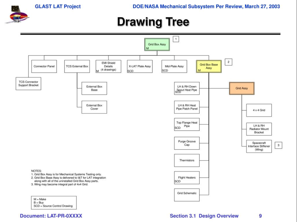

Well, the search was ALMOST useless because all I found was sketched pictures of, well, TREE, trees.  But I finally found an Engineering Drawing Tree.  Had to search for that specific term.  What it does is break down assemblies into their sub-assemblies and parts.  This isn't a very good one, but it'll do.  You can see 3 levels of assembly here.  I know we can't do that since it would mean separate repeat regions all over, and how would we tie them together?  But, maybe a recursive BOM.....

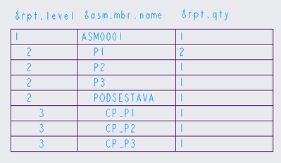

you can get following table
See drawing inside attached 2023-11-23.zip
