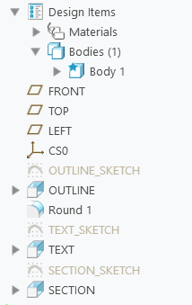

I am almost sure that you can create some dummy model and upload it -OR- at least show a picture of the Creo window including the model tree.
Note: PDF contains vector data showing model geometry. Text representation depends on the font type.
Martin Hanák
Model tree is as below, how it looks really isn't relevant. All the extrudes are in the same direction (TEXT and SECTION are material removal) and the drawing is a simple 2D of the label with some overall dimensions and a drawing border.
Can you please describe the process for saving a .drw file as a vector based PDF please?
