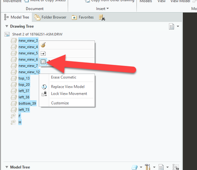

Select the views in the drawing tree, select the top, hold shift, select bottom, then RMB resume views
