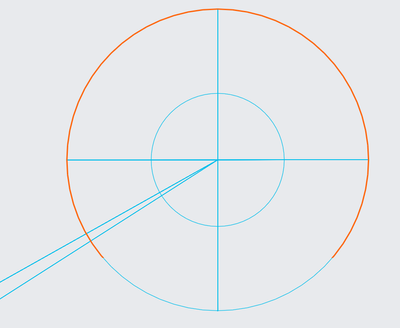

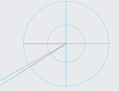

Lines being drawn slowly or not at all is usually a graphics problem.

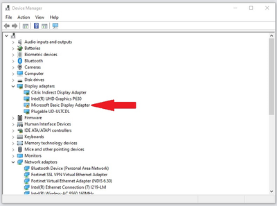

AM_9052294
(To:Chris3)
Thanks, Chris. You are right.  I needed to restart Creo to make sure the "graphics" option was read in correctly.  After it was, Creo seemed to behave correctly.  It didn't freeze!  I tested the hardware via gpu.userbenchmark.com and everything looked good.  So, I assumed I needed to roll back my graphics drivers.
I did this multiple times to ever earlier states and none of them worked.  I even went back to older driver builds than my coworker who uses the same hardware.
Ultimately Creo only seems to work when I completely wipe away the NVIDIA drivers and it runs on the default Microsoft Basic Display Adapter from 2006.
This doesn't seem right to me as it was working fine on the NVIDIA drivers last week.  I have to get work done so I guess I'll be working with the Microsoft driver for the moment, but I am curious what I am doing wrong and why I can't run NVIDIA drivers.  I have this feeling that using the Windows drivers is not ideal and could be lacking in some way, but at the moment Creo will at least allow me to get some work done.
Please let me know if you have any clue what's going on or what I should do next.  I really appreciate the help.

Sorry I didn't fully explain the use of the graphics  win32_gdi option, that was a mistake on my part.
Windows update breaks graphics drivers occasionally.
Your next steps would be to try different Nvidia drivers. But first, remove the graphics win32_gdi from the config.pro.
I always test the lastest driver first to see if it has the fixes needed. It's possible Nvidia already released a fix for your problem (if it was a windows update problem)
Then, if that doesn't work, I look at PTC certified systems that hopefully match my hardware and use the tested graphics driver.
https://www.ptc.com/support/-/media/support/refdocs/Creo_Parametric/8,-d-,0/creo8_hardware_notes.pdf?sc_lang=en
Then, if that doesn't work, it's a trial and error download of other graphics driver versions until hopefully it works.
