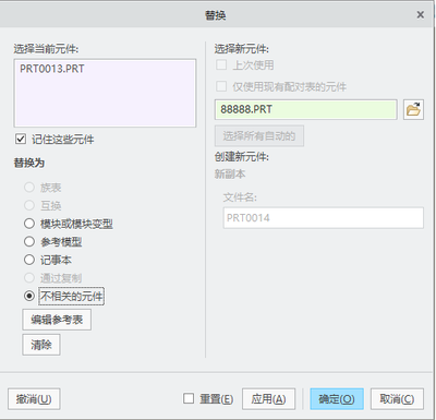

Application scenario: In the Creo component model, select the model to be replaced in the model tree, and replace the part or component model under the model by right-clicking - "[Replace] - [Irrelevant Components]" function.
Problem description: Only the interface "using component interface and family table" is found in Creo_protookit. No development interface related to "[Replace] - [Irrelevant Components]" was found. This interface is now required to achieve the need for automatic replacement.

应用场景:在Creo组件模型中,在模型树中选中需要替换的模型, 通过右键—“【替换】—【不相关的元件】”功能替换模型下的零件或组件模型。
问题描述: 在Creo_protookit中只找到了“使用元件界面和族表”的接口。没有找到 “【替换】—【不相关的元件】”相关的开发接口。现在需要这个的接口,来实现自动替换的需求。
