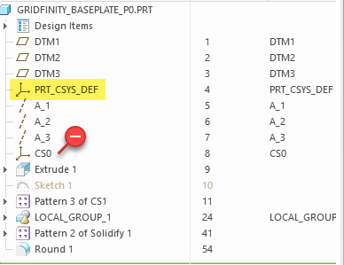

tbraxton
(To:Airfix)
Creo best practices are not universal. I have developed different practices for organizations based  on things like work flows, team organization/structure, user competency in Creo etc. I always ask clients to document desired outcomes and deliverables and let us figure out options for how to realize the goals. I cannot overstate how many times I have been in organizations that have immature or no processes documented and/or followed but are trying to deploy enterprise wide standards for CAD, PLM or the like and wasting tremendous amounts of money. Define the goals then look for options on how to reach them.
In my model CS0 is not the default csys. Prt_csys_def  is the default csys in the part. The orientation of the model is arbitrary and can be set your whatever your preference is using datums etc.
In general surfaces will regenerate faster than solid  geometry. I have exploited this in the patterns for fast regen.  Creo offers multiple ways to capture design intent, there is usually not a single "right" way to do it. I use surfacing in many cases that other Creo users would not. I would not associate more features with a more complex approach necessarily.
My intent was to build a baseplate generator model with a low range of 1x1 array expanding outward, so yes it would be a "master" in the context you ask about. You can use Pro/Program with this model to have a user enter the driving parameters if you wanted to. It is not the only way to generate the geometry in Creo and may not be the best in the context of workflow, team organization, etc.
In general I use UDFs from a library to modify models/designs, not start/create models. I am not saying it is wrong to do that but I have never even considered using a UDF as a start part.  I could be convinced otherwise.
