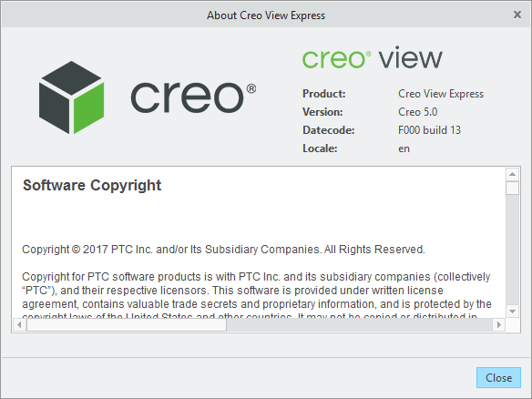

That is not the version of Creo View Express that ships (is bundled) with Creo Parametric 5.0.0.0.  I just did a clean install of Creo Parametric with Creo View Express and Creo View Express 5.0 F000 Build 13 was installed.
I also created a simple part in Creo Parametric 5.0 and then successfully opened this part in Creo View Express 5.0.  It would seem that when Creo Parametric 5.0 was installed on your computer the newer version of Creo View Express (5.0) was not installed.
