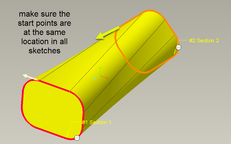

Hi, i'm not amazing with creo and am having a bit of trouble using the blend feature. I have used it before without issue but for simpler things. My problem is i'm trying to make a part where the top and bottom surfaces are the same shape, just one is rotated 8degrees compared to the other. When i try and do the blend for this in creo its not connecting the correct points together, for example the left face on the first sketch is connecting to the right face on the second. I've added some photos to make what i mean a bit clearer. Wondering if anyone can help?

Most likely it is the start point of your sections. You need to manually map the start points between the sketches.
