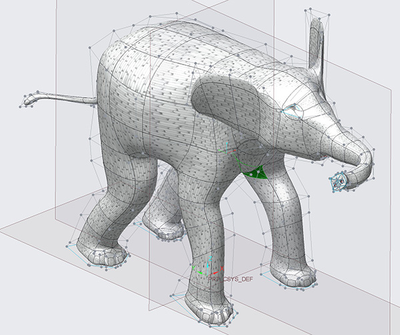

Baby Elephant pendant modeled during my WEEK TWO surfacing course.
  • What specific Freestyle tools were used?
-multiple shapes, extrude, mirror, rotational pattern of shape, subdivide, resolution modes, face split, edge split, crease, add edge, scale, transform

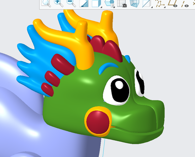

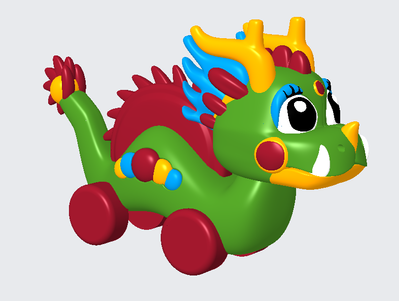

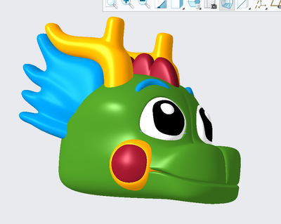

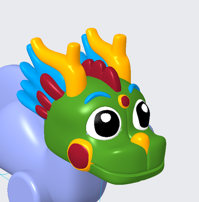

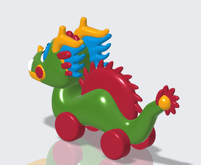

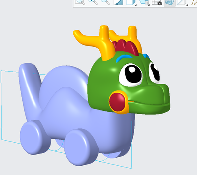

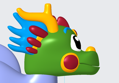

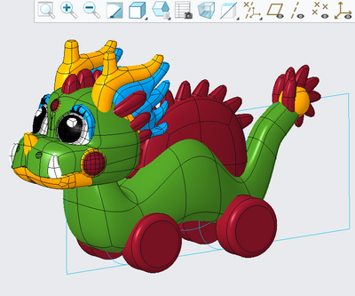

here's my start at a dragon toy, will keep adding details and pushing pulling the shapes.   I'm thinking along the lines of a Mr Potato Head type toy
been more than a few minutes since I worked in the toy industry
probably spent 1 hour so far, just playing with it once in a while
I had generated an image in ChatGpt as inspiration for this based on a family trip to Vietnam I just returned from.  I'll share that when I'm much further along.

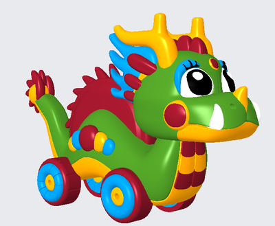

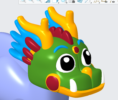

here it is a bit more refined with some pushing and pulling.
this is too much fun.   back to my regularly scheduled programming for a bit.

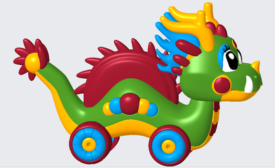

  Head area pretty good for now, will move on to body details.

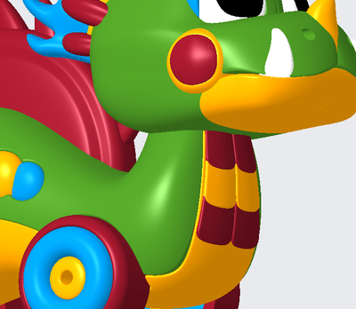

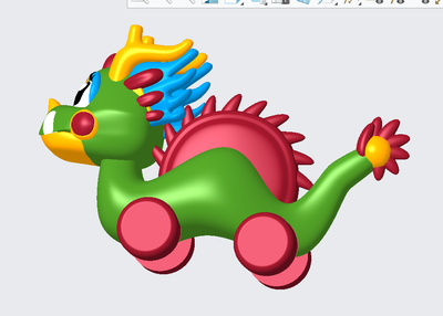

I was thinking this would've taken me a week to weeks in regular Creo or Style to create a G2 model like this, with no surface problems, considering all the changes I've made also.    So far, I'm probably about 8 hours in.

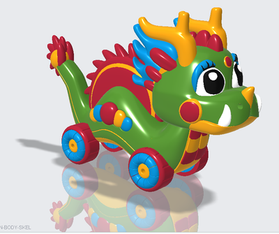

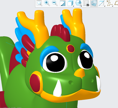

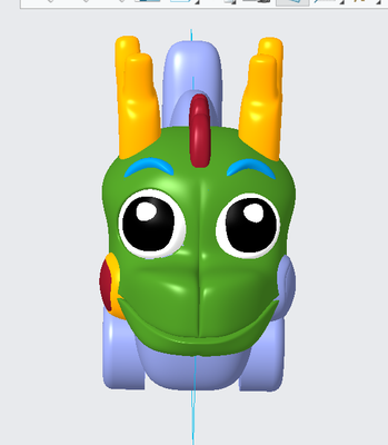

apologies if I'm spamming.   Trying to post as I add details to show the progression.  Had to split into separate models, Creo was slowing down quite a bit with the many freestyle shapes.     Not sure when I should upload models.

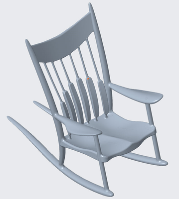

Anyone familiar with the furniture designer Sam Maloof, Alto Loma, California?
His chairs and furniture are works of art!  I believe I've only seen some "from afar" in person.
These are pieces that you need to touch to experience.
I like woodworking and "rocking chairs".
This was built using top down design...
~CP Hendsbee
