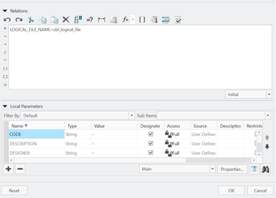

There is a creo relation function named "cbl_logical_file".
With that relation you can add a parameter to your assembly e.g.

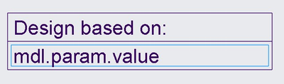

In a drawing you can then create a table where you display this parameter e.g.
Add a report parameter "&mdl.param.value"
Add a filter for the repeat region... "&mdl.param.name == LOGICAL_FILE_NAME"

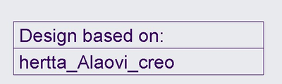

Then you can have a table that looks like... (My xml file was named "hertta_Alaovi_creo.xml")

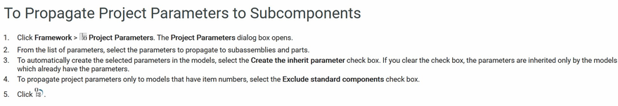

You can propagate this parameter to your subcomponents (harness parts or other) with these instructions (not normally needed)...
