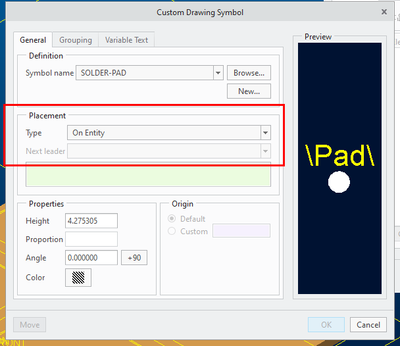

How do I place Symbols in an Assembly on an entity in Creo8?
The symbol handling and menu is completely different.
The goal is to place a Symbol an a before created DTM_PNT
This is how it was in Creo4:
Any help is much appreciated.
Best Regards
Maximilian

Welcome to Creo 8.
See this article: https://www.ptc.com/en/support/article/CS374885
MR_9902271
(To:TomU)
Wow Thanks! That helped a lot.
Also that the "On entity" is now hidden in the right mouse button menu during the placement and nowhere else,
Never would I have found this without your response.
