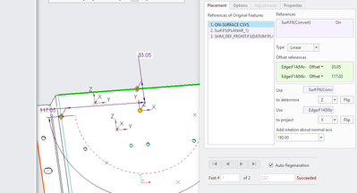

From the screenshot, it seems that when you were defining the UDF, you included the coordinate system in the list of features that will comprise the UDF.  And I suspect that in the source model, this CSYS is defined to be "on surface" and uses 2 linear references (e.g. edges of the surface) to locate it.
Perhaps I am mistaken in my assumption that you expect that during placement in the target model, the software can redefine the features being copied (i.e. change the source CSYS that was defined as "on surface + 2 linear dimensions" to be one that is defined as "on point + 2 orientations" or "offset from another coordinate system")
That's not how UDFs work - they are essentially "copies" and their references in the target model must match those in the source model.

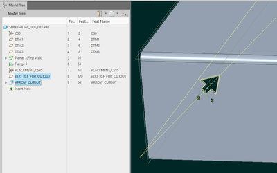

This is where I'm confused as to why you need that CSYS in the UDF definition.  I would approach it this way:
Define the UDF to comprise of only the essential features:
Note there are 2 only features in the UDF - The "PLACEMENT_CSYS" feature is not part of the UDF!
Also, the VERT_REF_FOR_CUTOUT plane is defined as "through the YZ axes of the PLACEMENT_CSYS"
It is used as the "right plane" that orients the "ARROW_CUTOUT" sketch, which itself is placed on the surface being cut.
So the two features that comprise the cutout need 2 references: 1) placement csys, 2) surface to be cut

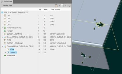

Then in the target model, before I bring in the UDF, I first create the CSYS which will locate the cutout:
The result will be a group with the copy of the 2 features, both based on the CSYS in the target model:
Here is another copy, and note the CSYS for the 2nd placement (CUTOUT_LOCATION2) is defined as "on point" (PNT0):
