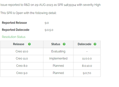

Currently running 9.0.5.0 on two work stations and the issue as stated in the following post was not resolved:
https://community.ptc.com/t5/3D-Part-Assembly-Design/Cursor-not-visible-in-family-table-cell/m-p/875073/thread-id/129131#M129649
Going to either open a new case or see if the previous one can be reopened.
(Previous case: 16880414)

Re-opening the case.
Dale_Rosema
(To:Dale_Rosema)
New case number
Case 16997701 has been opened.
It is inconsistent. Hit F2 in one cell and the cursor is there. Hit F2 in another cell and the cursor is not visible.
I was able to reproduce it for the Creo Tech person.

The case has been assigned SPR14839314 with a high level of severity.
Also noted was that when  cell is empty and you move your cursor to the cell using the arrow keys the cell doesn't show any indication of its location.
When a cell has contents, the color flips (black on white becomes white on black).

Creo 9.0.7.0 installed today and the cursor is visible when editing a family table cell using "F2".
Woo-hoo. No more playing "Guess where the cursor is in the cell"!
