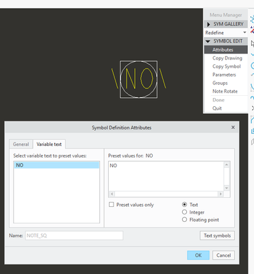

In Creo 5, I am creating a custom BOM balloon. In the custom symbol, I have added a note below the balloon to allocate space for entering quantity manually as shown. After placing the BOM balloon, shouldn't there be a way to change the value for 'QTY'? Double-clicking the balloon, there is no option to do so it seems. Thanks.

Is this a "driven" balloon for a repeat region BOM or is it just a symbol that is completely manually driven?
On a repeat region balloon, I don't think there is a way to add modifiable text for each balloon.
For a manual symbol, when you create it, it looks like you have it correct with the slashes.In the symbol creation , when you select the text and then attributes, select variable text to see the variable stuff.

This is a driven balloon for a repeat region. The Attributes dialogue box has a radio button 'Preset values only'. What does this do?

Preset values is when there is a limited number of "values" a user can set an item to, maybe A, B, C, D only, no other values allowed.
I have never seen a repeat region balloon with modifiable values. If you really need modifiable values, you may want to look in to component parameters that you will be able to use within your BOM table/ BOM Balloons

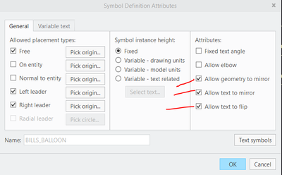

is there a way to drag the part number and description to the other side of the balloon in a smart balloon symbol. I can pull the drag handle so that the leader changes sides, but can you do this for the text outside of the balloon?

I thought one of these options would enable that type of functionality, but it does not appear to be the case.

You can't drag it. You can make the symbol able to rotate, keeping the text not rotated.
Try using properties on the symbol, and use the +90 button to rotate. You'll have to experiment which option allows that. I can't remember right off hand.

yes, bingo, that worked. right-click the symbol>properties>+180 as shown below. Thank you, Stephen.

but...it inverted the quantity and find number inside the balloon...ahh
