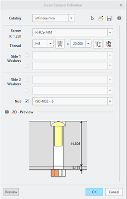

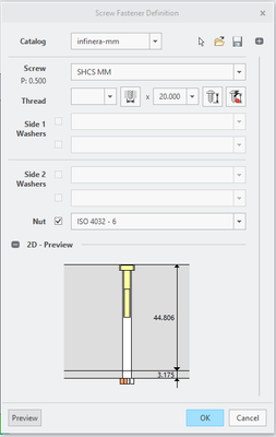

Having an issue where my socket-head metric screw menu is blank even though the .dat file has dozens of options. There are three other screw types in my 'mm' catalog: low head, flat, and round. Those three files work fine (and are built the same as the socket head). I cannot figure out the how and why. I will include my files
There are no options for THREAD in the SHCS-MM window. All three other sizes work/ match the .dat file.

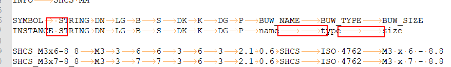

there are errors inside your shcs-mm file.
You always have to separate your entries with ONE tab.
Also the extension of the fastener data file must be 'dat'.

Oli,
I figured I had errors in this file but it was beyond me on how to resolve them. Thank you for the info and quick lesson! I did not realize I needed one TAB spacing. I respaced the two column headers and the file works. Such a simple fix. I know better now.
Thank you.
