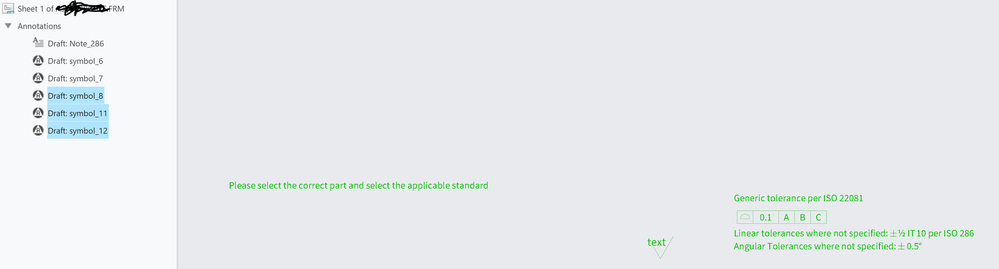

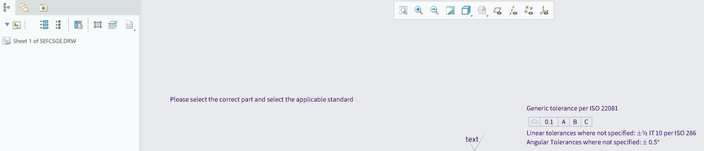

I'm struggling about creating a new format in our company's drawing, we are using Creo 9.0.4.0.
I want to add some selectable notes in the drawing and I succeeded by creating a custom symbol. I can customize it when I am still redesigning the format file, change the values, move it, everything rocks.
Now when I want to create a drawing with this format, I cannot customize nor move the symbols anymore. They are frozen as they are printed on the paper and I cannot even try to customize it at all as they are not present in the symbol list at all.
Do you know if I missed some parameters in the config, in the dtl or in the symbol itself so that I can at least customize it?

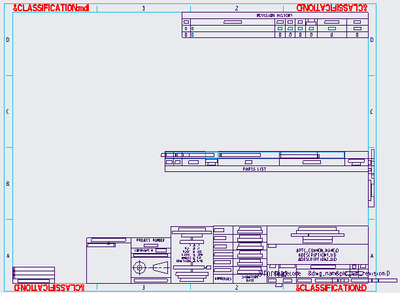

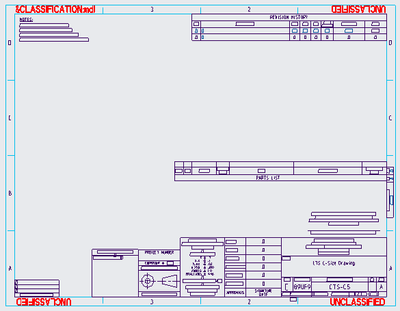

In simple terms, to start, the format is the drawing border and tables for the titleblock. You can then create a template utilizing the format but add additional things to it, like symbols, notes and some people even add views. The views can populate automatically when you create a new drawing using the template.
About Drawing Templates
This one of our formats
This the drawing template that we use to create drawings with
The format has the parameters in it.
The template has those values filled in from the parameter table.
