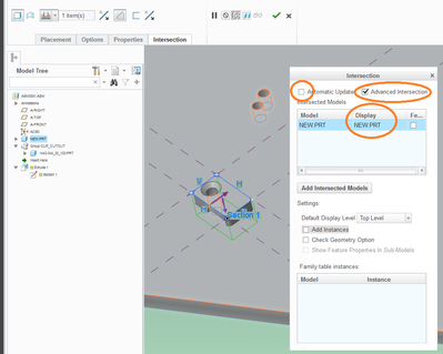

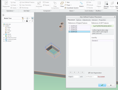

Well, it worked well enough for what I tried.  Sure, UDF didn't automate everything - but 95% is still a time saver...
That 5% was the relatively easy task of re-defining the extrude feature that does the cutout and changing from "automatic" intersection to manually specifying the parts that will be intersected.  In this example, a UDF was created that contains a clip component and an extrude feature that defines the cutout.  Note the sketch geometry of the cutout depends on the geometry of the clip:
1) assembly showing the "panel" part1) assembly showing the "panel" part
 The clip part needs 3 references to be placed (the top face of the panel, cylindrical surface of the screw-hole, and the edge surface of the panel to establish clip's "clocking angle".  The 4th reference is required by the extrude feature - it specifies its "depth of cut":

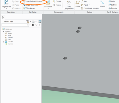

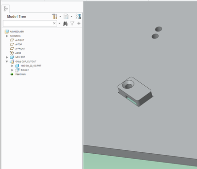

2) UDF added - note the panel is cut-out, but so is the clip2) UDF added - note the panel is cut-out, but so is the clipSo redefine the extrude - the changes are needed in how the feature intersects the assembled components, because by default, it is an "automatic update" (hence the clip itself is cut upon initial placement), and the cutout only shows up in the assembly context.  Here is the screenshot after re-defining:
3) redefining what the extrude cut intersects and where the cutout feature lives3) redefining what the extrude cut intersects and where the cutout feature lives4) final placement4) final placement
Is this kind of workflow useful to you?  You have to weigh the time savings of getting most of the repetitive work done for you vs the time to set up and maintain the UDF...
