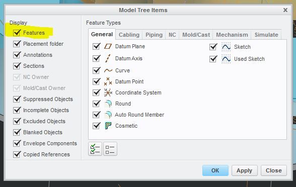

@vora5678 wrote:
And this operation is not shown in model tree history...
It should be, in the part.
Check your model tree settings. Are features turned off in assy mode?

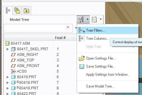

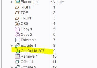

Doug Schaefer | Experienced Mechanical Design Engineer
LinkedIn
vora5678
(To:dgschaefer)
Im not sure for feature are disabled in assembly is that any perticular settings?
Check your model tree settings, I think they are turned off in assy mode by default.
LinkedIn
