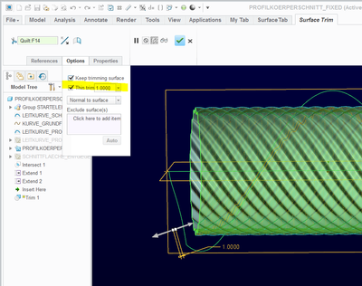

Hello, community,
I am still using Creo1.0 and have a problem cutting with surfaces created via Trajpar.
With a straight cylinder without profile this works but if I insert a notch I get an error message.
My real goal is to cut a twisted profile cylinder (hidden in the file). Here it only works in one direction.
Where is my fault?

You model is an academic version so I cannot see the model, but I can see the icon sufficiently.
Were you using merge to trim the surfaces or a sweep-cut?
You can try intersect; you can try trim...  The intersect shape is somewhat complex.
Creo has a hard time with these sometimes.
Is there a reason you are doing this in an empty assembly file rather than a part file?

Interesting... didn't know that was there in the trim feature:
Creo 3 attached:
Notice that I extended the two ends 1st.
This is in order to manage the thickness at the ends.
Thanks, the cut works now. Only unfortunately the cut body remains.
But I want to keep or continue to use exactly this cut out strip.
Do you have any idea how I could keep this stripe?
TomD.inPDX
(To:Raisch)
Yes, the option above thickness is to "keep trimming surface"
I  have now updated to creo 3.0. I didn't make myself clear.
That's why I added a cylinder surface with a straight profile for demonstration purposes. This allows me to cut tapes in both directions using trajpar controlled cut surfaces (see group PROFIL_GERADE).
But if I twisted the cylinder surface I can only cut in one direction (see group PROFIL_GEDREHT) hidden in the model. I don't understand why.
