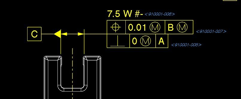

using CREO 4, I have defined a Datum plane (in 3D model using Annotate Feature - C in this pic) related to a dimension.
In the drawing I can see this Datum Ref in the view in which I see the dimension.
But, is it possible, with some tricks, to visualize the same datum plane in other views ?
I know that it's possible if the Datum is related to a surface, but I need to keep the relation to a dimension.

Hello Pier,
I do not know if you have found a solution yet?
In fact I have the same problem, I have a reference to a cylindrical surface, in order to show it on several views, I attached the reference to the surface in 3D model.
The problem is I cannot move the tag along the dimension, I can only put the tag on the surface itself.
If this could work, it could be a workaround
