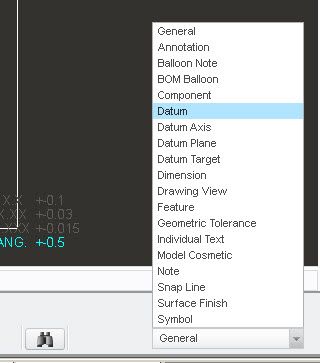

I am new to Creo & wondering how t erase the datum planes that are in this drawing view. The assembly drawing was copied from an existing Wildfire drawing. I would have just chosen to erase all from the view previously.  I do not see where there is an option to erase all.

Set the filter in the lower right to datum and then drag a window around all the view.
Also, if you have maintenance, vote for this IDEA.
https://community.ptc.com/t5/Creo-Ideas/quot-Set-Datums-quot-should-be-hidden-by-default-when-placing-a/idi-p/460708/jump-to/first-unread-message

I am picking them one by one to erase, just thought I should be able to erase all by view like we used to be able to. It's very tedious when you have some many to get rid of.

Thank you - that worked great. I will vote for idea as well.
