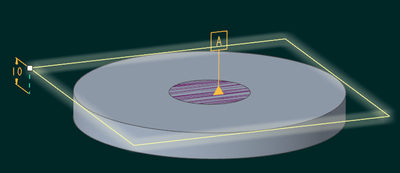

Hello everyone,
I used family table to create two parts. In the generic part datum A was created on a plane. But this plane (feature) is suppressed in the instance part, so one error occored. But the change and this datum A is needed in the instance part. Could you please tell me how to do it with MBD? Thanks in advance.

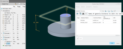

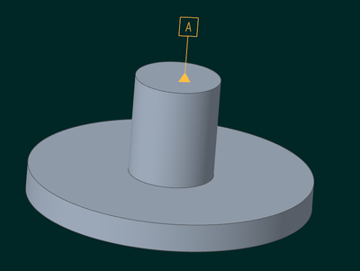

Well, I "faked it" by attaching the datum tag to a surface:
Generic:
instance:
This construction fill surface was then hidden away.  You should also add some relations so it follows the relevant feature sizes.

The Creo error with the annotation is resolved in this model for the generic and the instance. The annotation plane A is present in the instance without error.I have questions  about documenting a plane on a part that can not be established on the part for inspection but I suppose that is a separate issue.

You have to redefine the plane you are using for Datum A so it is not suppressed in the instance. This kind of thing happens a lot with section views, etc. You have to be careful when defining features to avoid using references that will be suppressed in instances from a family table. Check your references and replace them.

This would be an option to establish a datum reference plane in the context of your family table.

@sundoopi , are you trying to accomplish this:
generic:
instance:
yes!
Generic:
instance:
Hello all,
thanks for your answers. It looks, that we have to trick the message center with a "faked datum plane".
