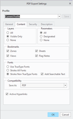

There are a lot of things to consider.
What is the size of the drawing?  If it is D size, the PDF is creating a 34" x 22" page, not just 8.5 x 11.  It is formatted to print clearly at the full sheet size.
Look at the content tab.  All of the items checked add more information to the file.
