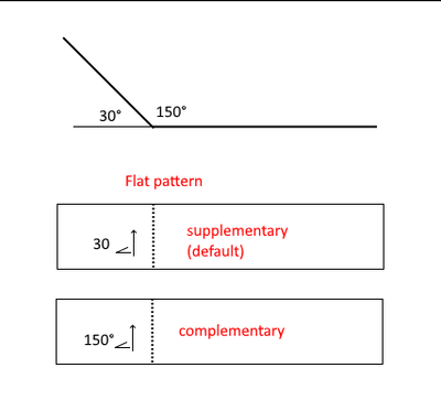

how to set and make default complementary angle when creating flat pattern view?
Software version: Creo Parametric 6.0.5.1

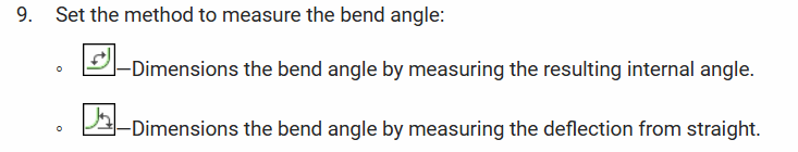

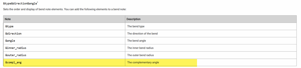

There is a sheet metal config option that can be set such that the complimentary angle is used for bend notes.
FYI: There is an option to do this when creating a bend with a surface reference. Refer to step 9 in the following link.
To Create a Bend with a Surface Reference (ptc.com)

GH_9260430
(To:tbraxton)
Thank you very much! It works!
