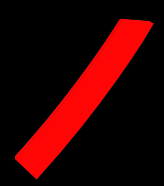

what's the best way to define part with curved shape?
Please see the picture attached.
I need to make a drawing of this part. And what I was planning on doing is to place the points along the curve and dimension them within the coordinate system.
When I add sketch points to the curve, the dimension doesn't grab them and doesn't dimension them.
When I try to add points in the model, it's not very straight forward.
Your help is highly appreciated.
RMB+hold@selection to get the selection menu and choose "pick from list". There you will find your point element as long as it is visible.
