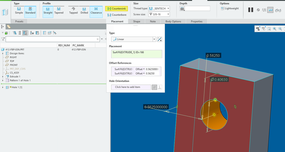

It is very easy to duplicate if it is going to crash the system or not.
Open the part, edit the hole feature, change from a clearance hole to a clearance hole with a countersink, and click OK.  The entire system will freeze up and you have to power down the computer.
I have tried this on multiple computers (laptop and desktop) and have had random results.  It seems that the crash happens on computer that do not have an approved graphics card.
Changing the setting graphics win32_gdi does fix the problem but the performance if far too slow.  Never had this issue with Creo 9 or 10.

no problem in my Creo 12.4.0.0. I entered 0.5 countersink diameter on Shape tab.
Creo Parametric Graphics Type: OPENGL
	 Using hardware accelerated OpenGL.
------------OpenGL Graphics Info-----------
Running on Windows
OpenGL Vendor   : Intel
OpenGL Renderer : Intel(R) UHD Graphics 620
OpenGL Version  : 4.6.0 - Build 31.0.101.2125
OpenGL Vertex Buffer : Supported
OpenGL Frame  Buffer : Supported
OpenGL Material Shader : Supported
OpenGL OIT Transparency Shader : Supported
OpenGL GPU Line rendering : Disabled
Screen Resolution 1920 x 1200 pixels
HDPI Text Scale 1.000000
Graphics Card Does Not Support Render Studio GPU mode

If the graphics win32_gdi fixes the problem with respect to the crash, it is a graphic card OR DRIVER issue. Remove the graphics options and you need to try newer or older graphics  card drivers. In cases like this, i make sure and try the latest "approved" driver that ptc had listed. If that doesn't work,I go straight to the lastest driver, then work my way back to try to find one that works. The couple of times I have had to do this, it only took 2 or 3 tries to get one that worked.
Hopefully it helps.
Hi @TD_10203231,
If so, please mark the appropriate reply as the Accepted Solution or please feel free to detail in a reply what has helped you and mark it as the Accepted Solution. It will help other members who may have the same question.
Catalina
PTC Community Moderator
PTC
often problems are related to graphic card drivers. Please open you config.pro file in Notepad and add following line at the end of file. Note: The option is used for testing purposes, only! Is is not intended for real work.
graphics win32_gdi
Then test Creo behavior. If it works well then you have to update graphic card drivers.
Q1: What graphic card is installed in Dell Precision 7760?
Q2: What graphic card drivers version is installed?
According to https://www.ptc.com/en/support/refdoc/Creo_Parametric/Vendor_Hardware/Dell_12?action=view page Precision 7780 is supported.
According to https://www.productindetail.com/cn/comparison-dell-precision-7760-vs-dell-precision-7780 page the main difference is graphic card. Therefore I think that it is the route of the problem.

I finally received a fix from PTC and it seems to be working so far.
By adding enable_opengl_fbo to the config.pro seems to have fixed the problem. (fingers crossed)
Forgot to post the entire line to add to the config.pro
enable_opengl_fbo no
